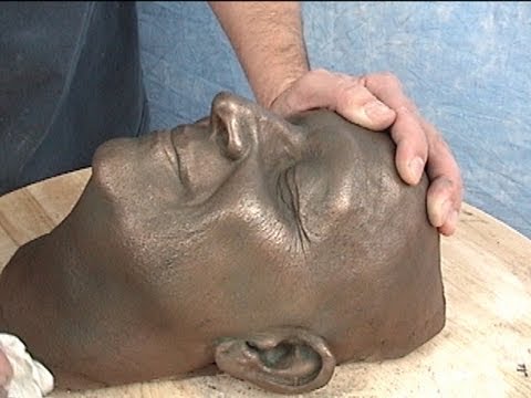

I will be Lining the surface of the mask mold with the gold powder. It loves to stick to silicone. then pouring a small amount of rotocast resin which will create a thin but strong shell. The gold will remain on the outside of the resin cast so when I buff it it should look splendid.I will reinforce the resin cast with Fiberglass. Like this but in gold.
In another day or two you will see high quality images of the finished results. And the fibreglass masks I am making in the future should turn out even better.
The visor part was made by heating a tinted acrylic sheet and forming it to the right shape to fit in the mask. Lights behind the Visor would have allowed people to see through it and made it harder to see out. which given the shape of the mask is already a little tricky. Eljay is going to bump into a few things while at brickfair.
