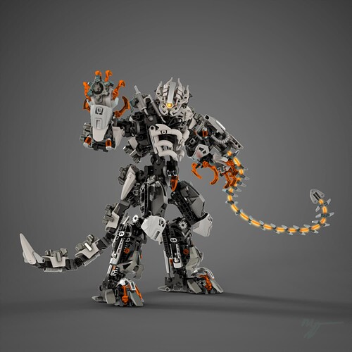

Gathered friends, I present the anti-Toa sentinel unit; the one-eyed golem of unparalleled power; the protosteel spear of the old gods; the hidden monster of the Great Vault; the gate-breaking, earth-shaking, hunter of heroes itself– the Marendar.
Main Build Features
Massive disclaimer: I’m a digital builder. All of my work is essentially theoretical. I don’t have significant experience with building in real life, so I hope you can cut me some slack when analyzing the structure. Over the years, I’ve sought advice from some friends who do, though, with regards to testing the techniques I use in the Stud.io canvas. Unless someone 100% recreates the model, however, we’re never gonna find out completely if this absolute unit will even stand up. All I know is that all the connections I’ve applied are theoretically plausible; they should work, on the basis of established LEGO connectivity systems. Perhaps there were better ways to apply some connections or even cleaner ways to reduce greebling, but I digress.
POST_Piece Count
Let’s start with the piece count— a total of 810 pieces, which is a nod to our beloved franchise, but more particularly, the date for Bionicle Day. 27 of these pieces are custom colored, with 22 of them being the Ben 10 spikes on one of the weapons; these pieces only exist in Magenta and are incredibly rare. A total of 27 over 810 is 3.33%, granting the model a 96.67% replicability using official existing parts. I’m afraid resin/3D printing commissions and/or painting may be required for these custom pieces.
The remaining five custom pieces are one Trans-Neon Orange Hero Factory Head with a Handle, two Silver Glatorian Ankle Armor pieces, and two Silver HF Helmet Visors.
Given how scarce some LEGO parts are nowadays on top of being inhumanly expensive and all too unavailable for a lot of people worldwide, I find the 3D modeling and printing artists out there quite a godsend to our community. I’d support them all if I could. Buying parts from them isn’t so different from buying LEGO parts from a seller. Apropos of that:
Let’s get to the selling point– the head. Utilizing the HF Head with a Handle as the base, System piece connections cradle the ‘skull’ to create the intricate texture. While said skull piece does not officially exist in Trans-Neon Orange,
DuckBricks has offered to sell a resin print of it in that exact color at his store for everyone’s convenience (hopefully including the other Trans-Neon pieces I used). I’m holding you to that, buddy :stuck_out_tongue:
Onto the second selling point, coming in hot at twice the speed– the arms. Composed of mainly Technic pieces, the segments are nearly hollow and rather light.
Utilizing Technic “ratchet” connections (inspired by Kutorakh’s own Marendar), the arms provide firm enough articulation and stability.
The digitigrade legs follow a double joint flow in the thigh-hip and thigh-knee connections, a triple joint flow in the hind-shin connection, and a double joint flow with a piston in the lower leg-foot connection. Hopefully the friction applied to the legs is sufficient after all that; if anything, I’d at least like for my model to be able to stand on its own.
The system behind the feet is borrowed from Gamma_ray’s Tauntaun build, making use of doubled up ball-joint connections for reinforced articulation in two axes. The feet can bend forward and backward and ankles side to side. It cannot swivel left to right, however, but then again, neither can ours. The proportions of the legs and feet compared to the rest of the body now provide enough balancing to support the overall weight of the model. Speaking of balance:
The tail is composed of five sections– one base, three segments, and one tip. The Tail Base-Hip connection is triple joint supported with the succeeding segments being only single joint connections reinforced by joint extenders and… physics.
Because Marendar is canonically known to have ‘specialized weapons’ that can possibly adapt to its Toa prey, I opted for one melee weapon and one ranged weapon to cover basic combat.

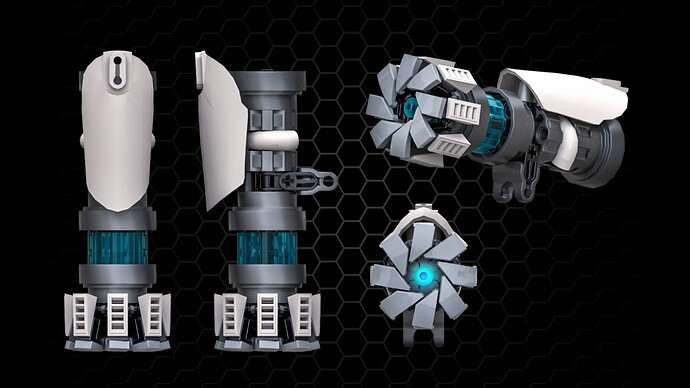

The Aperture Cannon is based on the DSLR camera’s aperture. With a long axle in the center, the weapon provides a spinning play feature.
The Chain Sword is based on Gipsy Danger’s same weapon from Pacific Rim. The Ben 10 spikes are held together by one long Axle, which can be replaced with a long Rigid Hose, or flextube, to mimic the Chain Sword’s whip form.
On the wrist of each arm contains a Liftarm with a Ball Joint in the middle covered by a CCBS shell and armor; on this ball joint attaches each weapon as a wrist mount when the shell is removed. That ball joint is not exclusive, however, to just the two weapons. Having that connection creates opportunity for further customization with all sorts of weapons attached with a Joint Connector.
The torso is the most complex part of the model, being composed of several Technic Liftarms to support axle-based connections, CCBS shells to cover them, and ratchet jointed Torso-Hip articulation supported by pistons behind the rib cage.
The hip section is the true center of the model, having nine Ball Joint points, connecting to the Torso, the Tail Base, the Legs, and the subsequent support joints of the lower body.
Every Trans-Neon/Trans Orange piece used in the model also officially exists in other certain Trans colors, allowing for a recolor to represent the character’s “emotions”. Like I mentioned above, DuckBricks may sell a custom print of the Trans-Neon Orange skull. Who knows, though? If this model wins the Contest and his heart, maybe he’ll have like a Marendar Bundle of Custom Parts for sale to those who wanna recreate the model hehehehehehe Duck please

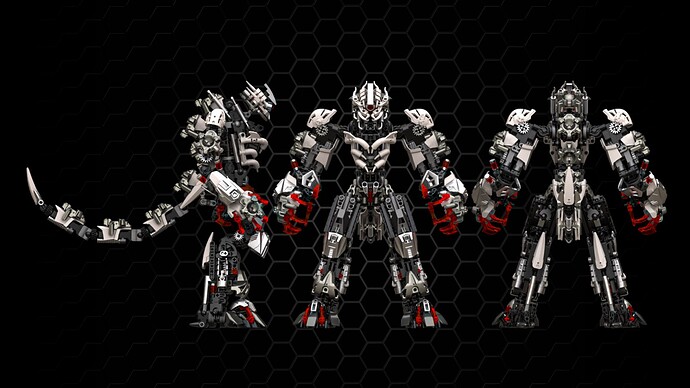

It’s time we addressed the mutated elephant in the room. Yes, the whole model, but mainly the head, is absolutely reminiscent of Michael Bay’s design for the Decepticon, Shockwave. Marendar, a creation programmed to eliminate its prey, is essentially an ‘experiment gone right’. Shockwave is known to experiment on and create his own killing machines, while also bearing a reputation as a lethal combatant himself. This design concept practically merges the creator and the creation, albeit unintentionally. To give Marendar a single eye to represent its single objective on top of a body designed after predatory animals seemed rather… logical.
While the design indeed has an uncanny resemblance to Michael Bay’s Shockwave, the head was actually actively conceived under inspiration from Neo-Shifters, and one of its particular sets I owned, Kero Tox. However, during the first draft stages when people started pointing out the similarity, I realized that perhaps it was a subconscious thing, a passive thing, for me to throw up a clone of Shockwave’s head. I decided to just roll [out] with it, over the years. Some of the design language of the set also carried over, such as the rigid, organic translucent textures. The same motif was applied with the legs and feet, mimicking the plated style of Michael Bay’s Transformers designs but with the organic elements sprinkled around; bones protruding around the mechanical frame.
While the weapons are very much inspired by existing weapon designs, both were modeled with specific ideas in mind. On top of the basic idea of having a close range and long range option to cover most forms of combat, the design language for each differs vastly.
This weapon was conceived with three specific concepts in mind.
  1. The aperture of a camera determines “how much light enters the picture”. Marendar is the contingency plan to eradicate Toa should they go rogue-- it literally ‘controls how much of the light side gets to stay in the big picture’; A natural gatekeeper.
  1. I realized that the hole of the aperture was shaped like an octagon. My partner pointed out that it actually looks like the Bagua Mirror. The Bagua Mirror in Chinese culture is a piece of furniture that, depending on how you place it in your house, wards off evil spirits and negative energy. I carried over both concepts to the cannon-- it wards off the rogue spirits. I shaped the barrel of the cannon to be convex as well, as a Convex Bagua Mirror deflects extreme negative energy in dire circumstances– appropriate for Marendar’s programming.
  1. Marendar’s color scheme was based on the video game Portal, whose antagonist organization is called Aperture Laboratories. This weapon serves as an Easter Egg of sorts to both the game and the Portal Gun itself.
Y’know… Pacific Rim.
Oh? You were expecting a clever, beautiful meaning behind the Chain Sword? Nah. I just like chainsaws and swords. Sheer terror, unbridled destruction and pure epicness were the goals here.
