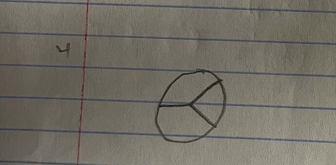

Consider just the possibilities of lines 1-5, 8-6, and 7-3.
Looking at them as bits gives us 2^3 possibilities
However, that doesn’t take into account these legal glyphs

This pattern fails to take into account this glyph, since there is no ‘first’ line in this glyph.
It also fails to take into account glyphs like this, since the center line doesn’t start at an edge. I’m not sure if this is a legal glyph,
but it looks cool, and similar to what we have seen, so I’m gonna assume its legal.
