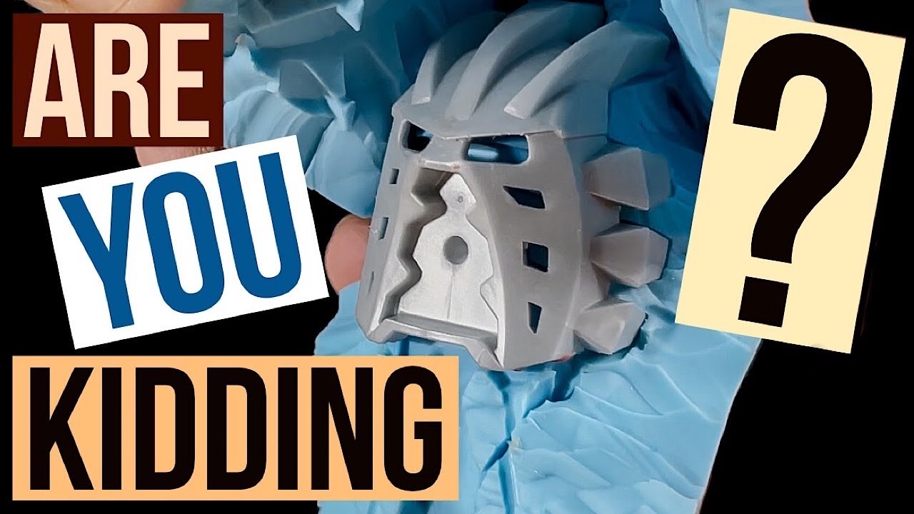

i found this video on youtube a year ago, this guy casts a lot of things and seems like a professional so this might be worth a try
the craftsman also has a few videos on mold making which may also be helpful. nothing bionicle-specific but it might still be helpful since he goes pretty in depth with the molding process

How’re you planning on making your masters?
I don’t know what that means, ive literally just picked up the idea of resin casting
A master is what you use to make the mold for your cast, aka you make 1 mask and then reproduce it in resin
oh that, like i said ive got no clue, my best guess is some kind of silicon or other rubbery material
That would be the mold material itself, I’m asking how you’re getting the design into the mold. Are you sculpting the masks by hand? Kitbashing them together? 3D printing?
oh probably just use a real mask if that doesn’t work my next best thing would be to use the school 3d printer

Important thing to remember is that not every fan made kanohi can be casted, at least not with a 2 part mold.
The original bionicle kanohi were limited by injection molding, which is why you got strange designs like the kraahkan.
Other fan designs, while impossible with a 2 part injection mold, are still possible with a 4 part injection mold. Case in point, Rothanak’s mask of psychometry.
Edit: I just realised the metru head is definitely another piece that uses a 4 part mold, since the hole to hold the brain stock and the ball joint are on a different axis from the face axis.
