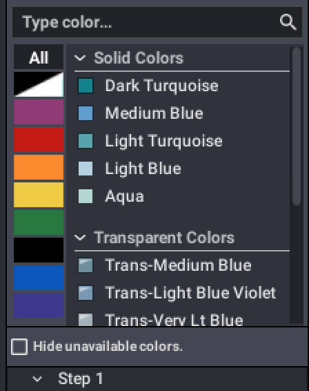

I have a Problem with Stud.io currently. A lot of the actual colors are removed since the newest update. (all pearl colors exept for 2, dark red, dark green, lime and more went missing)
Does anyone else have this problem?

Not sure about the custom colors, but for the main ones, I’d try seeing if replacing data/StudioColorDefinition.txt with this file (which should be the correct one for this version afaik) fixes it.
Probably back up the current one to be safe, also, I guess?
Yeah thank you. That somehow worked. And for some reason it got (a few) custom colors working (which is weird, they never worked for me) So probably messed up with the file I dont know how.
