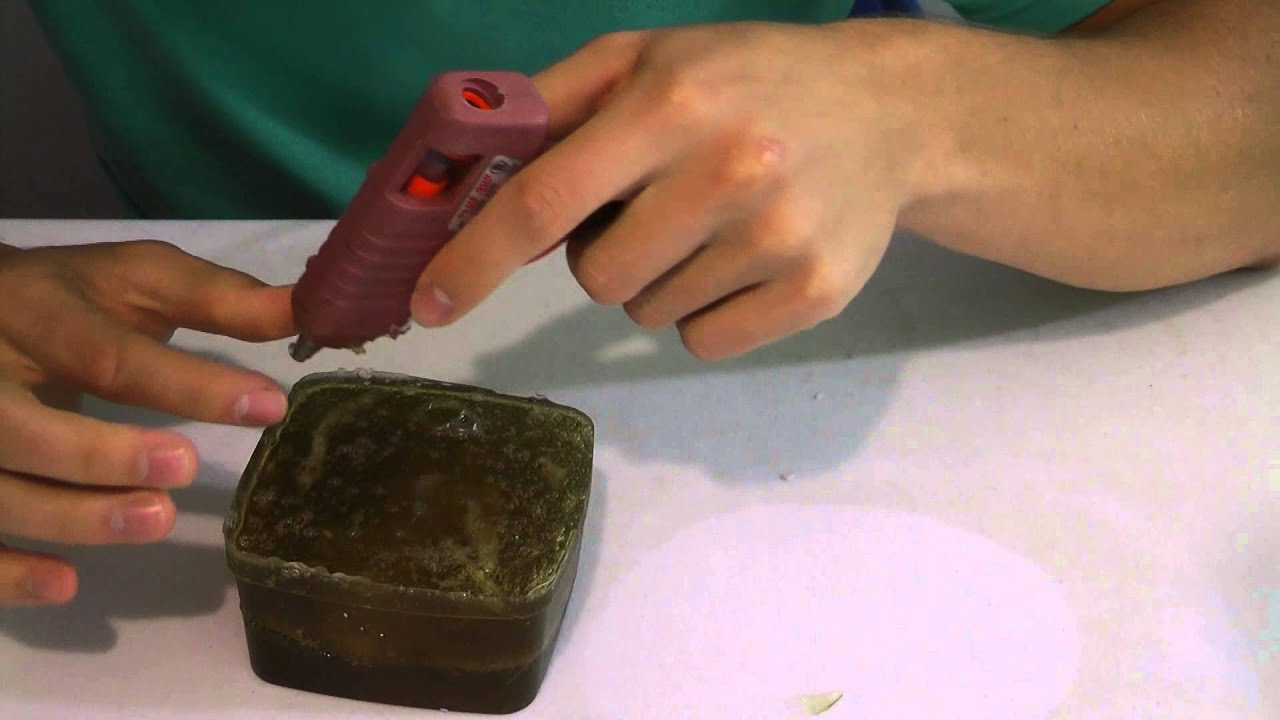

How about his one?

molding a part is simple, casting one is where it gets tricky. What kind of material to use, resin is easily available, but won’t have the proper tolerances.
Ideally you’d use the same kind of plastic that Lego does. Which could be tricky, or you could buy lego parts in the proper colors and melt them down.
Do you know if the method shown in the video above would work?(excluding the bit where he combined the sheep and lego piece).

Sorry to pester you again, but do you think the method shown in the video will work?
That was painful to watch, he does a lot of things wrong, but all he’s really doing is making a silicon mold, and then making a resin cast. You can do it just fine, but it won’t be as durable as the real parts. You’ll need to be careful with them and the tolerances won’t be the same as a real piece. It won’t fit perfectly because resin doesn’t stretch the way plastic does.
Resin is more useful for things like model kits where you don’t have to worry about joints. If you really want to do this method, I can point you to a far better tutorial that will make it easier and give you better results.
That would definitely be appreciated!
Yes please!
Here’s a tutorial by someone who does it far better, he also has another tutorial on using clear resin.

Do you know of a more durable material than resin? And a good tutorial for making duplicates with that material?
Past resin your best bet is to do it in actual plastic, of which I don’t know of any proper tutorials/
Someone already got to it before me.
Not quiiite up to Lego tolerances… But I guess how good can you get it…
